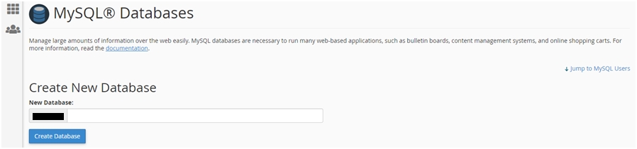

Step 1: Set up the database on the web server
  • Log into your website’s control panel.
  • Navigate to “MySQL® Databases” on your server.
  • Create a new database if you have not already got one you would like to add to.

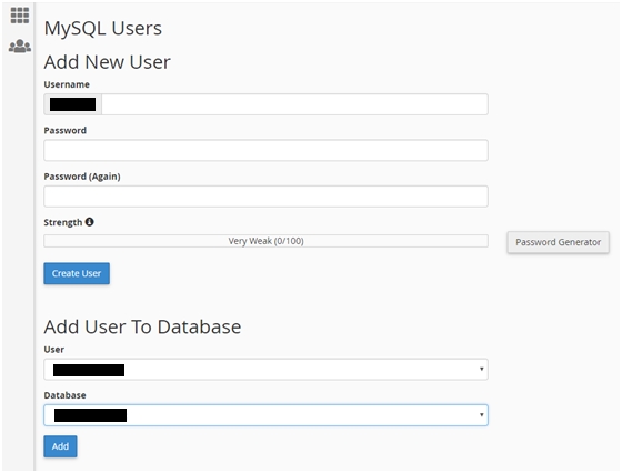

  • Navigate to “MySQL® Users”, usually found as part of the “MySQL® Databases” settings.
  • Create a new user if you do not already have one set up.
    •   Create a user name
    •   Create a password
    •   Select the database you would like that new user to be associated with.
[attachment=1474] [attachment=1475]

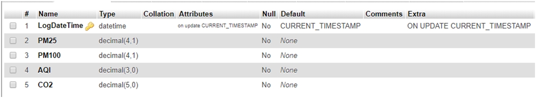

Step 3: Setting up the database structure / creating a new table
Now a table to store all the data in needs to be created within the newly created database.
  • Open up the database admin. This may be called something similar to “phpMyAdmin”.
  • Click on the database you would like to add the table to.
  • Find “Create Table” and give the table a meaningful name. For this example, we are going to be saving the air quality data, so naming it “AirQuality” would probably be best.
  • Count out the number of columns you will need for the data you will be saving – do not forget one for the date/time either.
  • Once the table is named and created, the columns will next need to be named and parameters set. This is where things get a little more difficult.
  • Save the results. Now a empty table within your database is ready to accept data.
  • Here is an example of the Air Quality table with the columns named and parameters set.
Additional columns can be created later on and parameters changed if the settings are not right first time around.
[attachment=1476]
