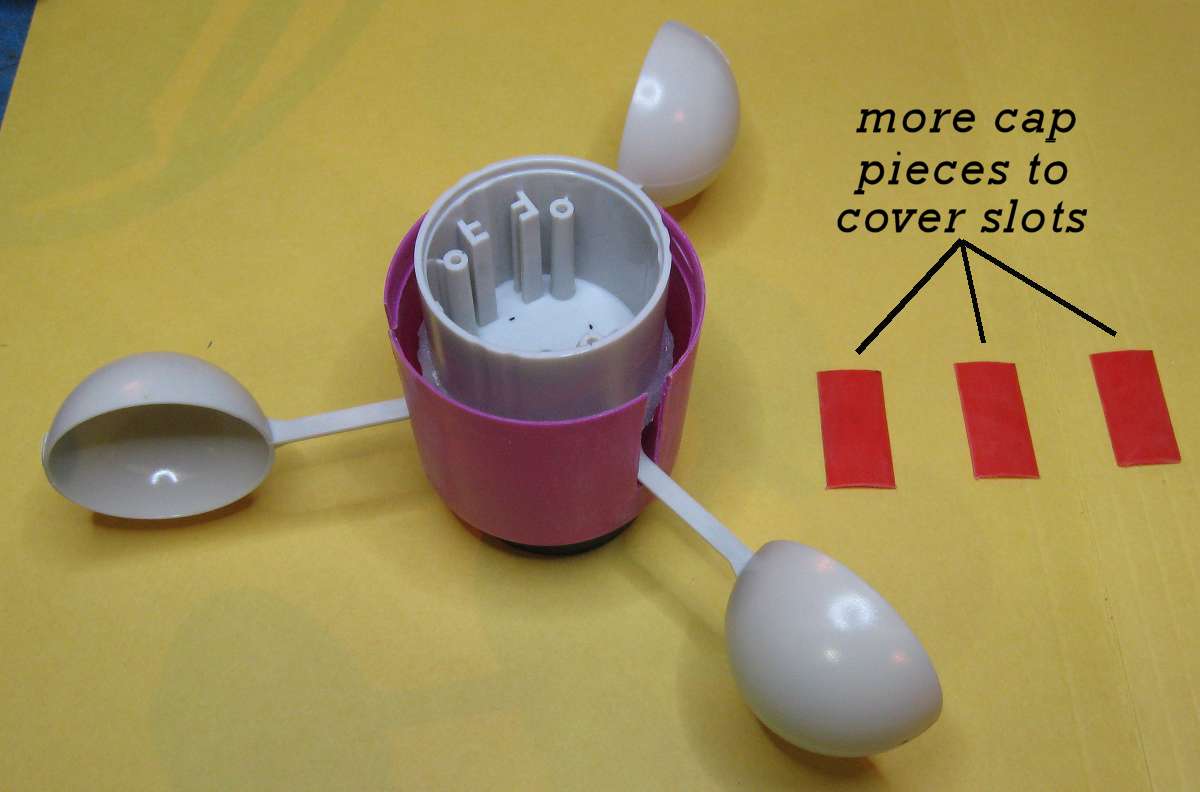

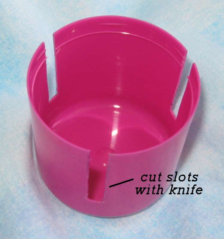

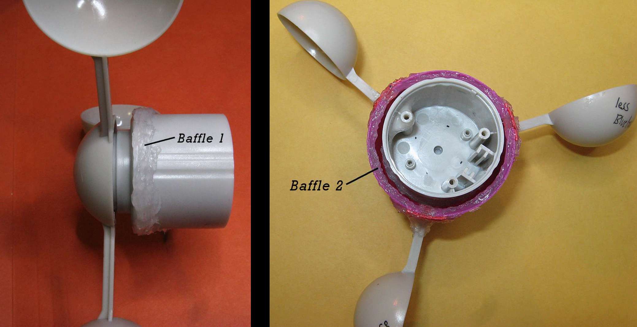

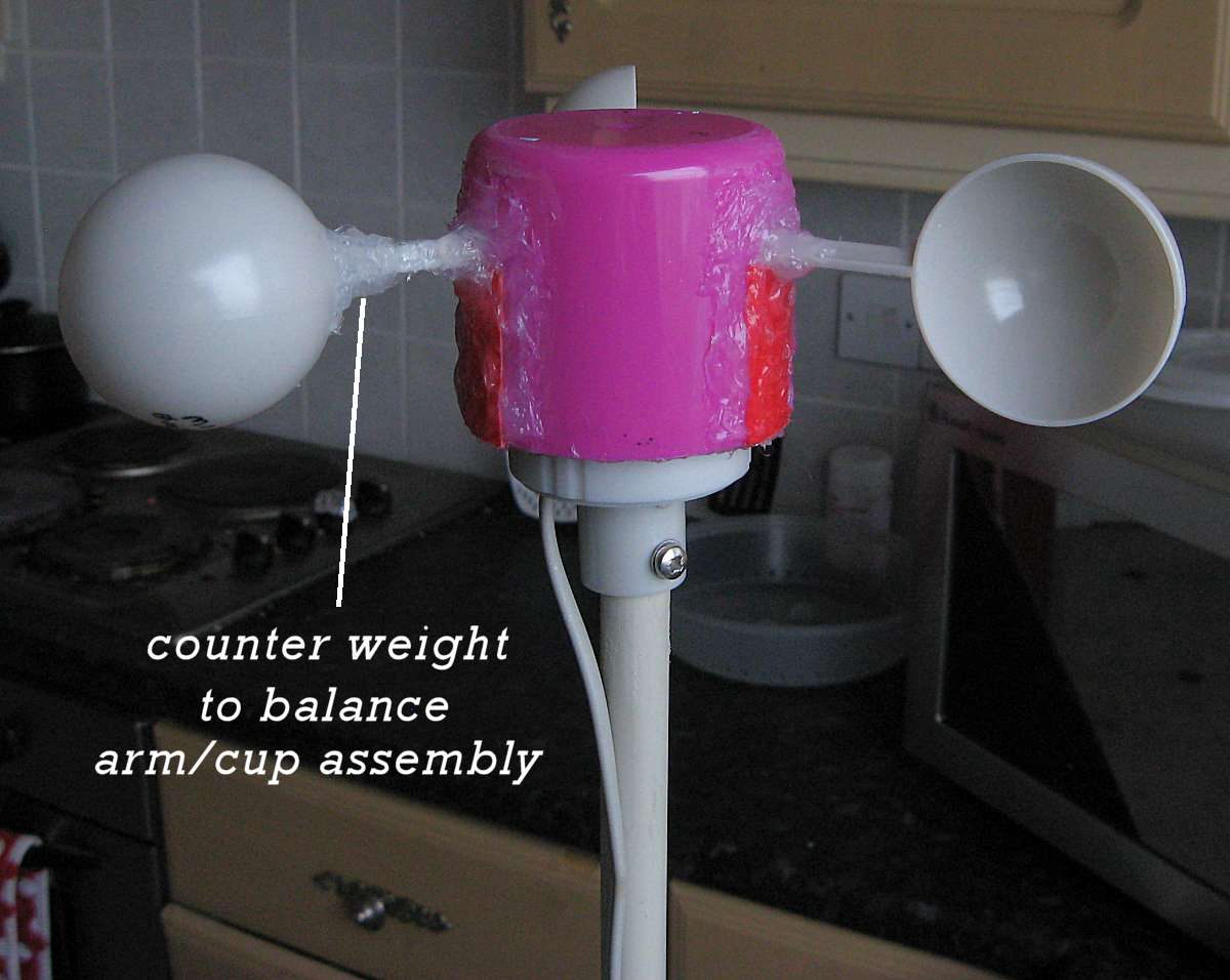

As cheap as the Fine Offset Anemometer is, it does appear to work quite well, but it does suffer from offering very limited protection against water ingress into the vicinity of the bearing. Any water ingress will for sure shorten the bearing lifespan, especially since it's not stainless steel. Despite the anemometer's low price I wanted a quick cheap method of increasing its resistance to rain. A simple plastic canister cap can be modified to act as a rain shield. A 52mm diameter plastic can cap has 3 slots cut into it that align with the anemometer cup arms. A bead of 2mm thick silicone sealant is applied around the top outside circumference of the stationary bearing housing to act as the second of two rain baffles. The cap is placed onto the anemometer arms, with the slot gaps in the cap being filled in with small cut out sections of glued on cap plastic Silicone sealant fills in any remaining gaps. Another bead of silicone sealant 2mm thick is applied to the lower inside circumference of the cap to act as the first of the two rain baffles. Oh, and a little bit of extra weight (silicone sealant) is added near the appropriate cups to dynamically balance the arms/cups assembly, as its weight distribution is not even due to both the single 'offset from centre' magnet attached on the underneath of the assembly, and the additional cap. This is done by holding the anemometer on its side and adding/removing weight by trial and error such that in any position across 360 degrees that the cups are manually moved to the cups stay stationary, with no tendency to rotate to a preferred position. Spinning in high wind speeds, an unbalanced cup/arm assembly will cause a lot of mechanical stress in the bearing and its mount. The pictures attached document the changes. The modified anemometer still needs to be calibrated using the 'moving car in calm conditions' method, but initial observations show its cup rotation rate versus windspeed is largely unchanged.
Cap with slot cut into it:
[attachment=1412]
Rain baffles:
[attachment=1416]

Modification complete:
[attachment=1417]
