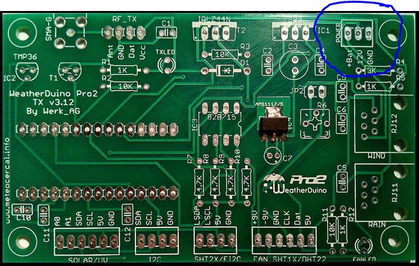

Sorry - more questions. Do I need to be worried about the Board Temp being at 59.9 degrees c in the webserver ? Does the voltage regulator in the TX board need a heat sink ?
G'day Pete.
60c isn't too bad for electronics usually.
But I take it this is being reported by the TMP36 and if then yes the regulator could be a lot hotter.
And yes, those linear 78xx or 79xx regulators should have a a heat sink.
Cheers UB

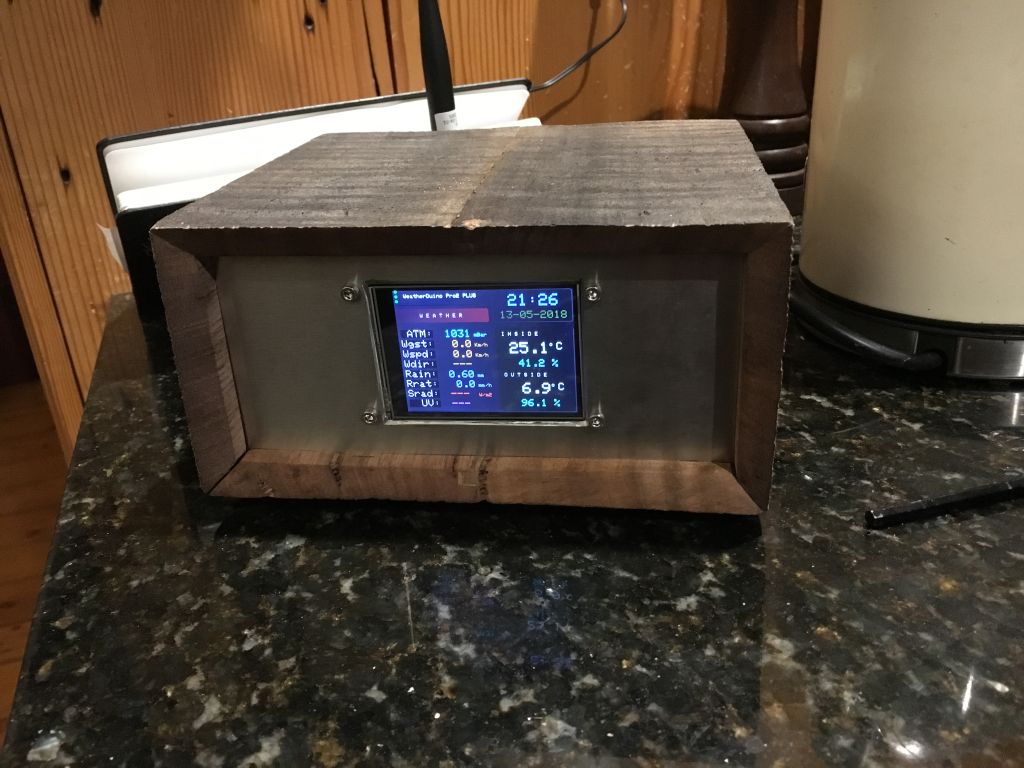

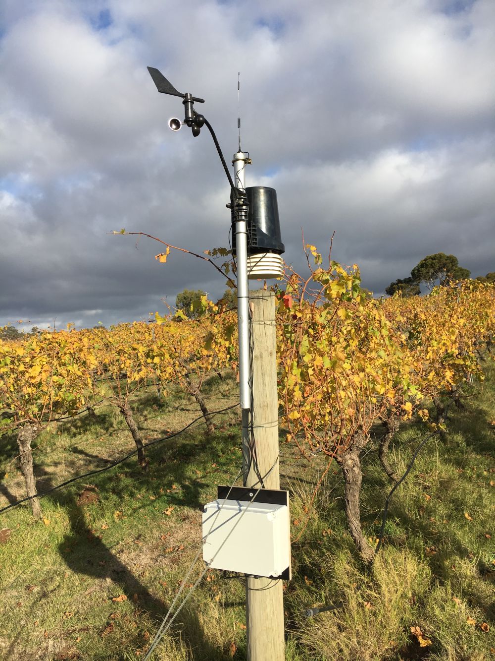

And, of course, we'd love to share some photos ...  Smile
[attachment=1462]
[attachment=1463]
Hopefully this works - if not I need instructions on how to post photos
(13-05-2018, 13:16)coupe pete Wrote: [ -> ]Hopefully this works - if not I need instructions on how to post photos
Good job!
With the weather station, the harvest will be great!  Smile
(13-05-2018, 10:49)coupe pete Wrote: [ -> ]Sorry - more questions. Do I need to be worried about the Board Temp being at 59.9 degrees c in the webserver ? Does the voltage regulator in the TX board need a heat sink ?
First of all thank you for your feedback about your new WeatherDuino Weather Station.
Regarding the reported high board temperature, this value (59.9ºC) generally happens when the TMP36 sensor isn't installed on the TX board. Please check that.
I really like the look of the receiver. Was the box designed from scratch to house the receiver? Very good job
Outside installation also looks very good. Smile
