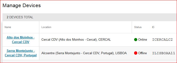

From what I can read on Cumulus Forum (thanks AllyCat for the link to the info) seems WU is currently having some issues.
I have two stations uploading to WU, at moment one is online (Green Icon on the RX) the other is offline (Red icon).

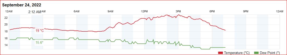

As always I'm using the upload key, and not the API key.
Currently, for me the situation remains the same than a few hours ago, one station is uploading, the other is offline. Don't know what is happening.
