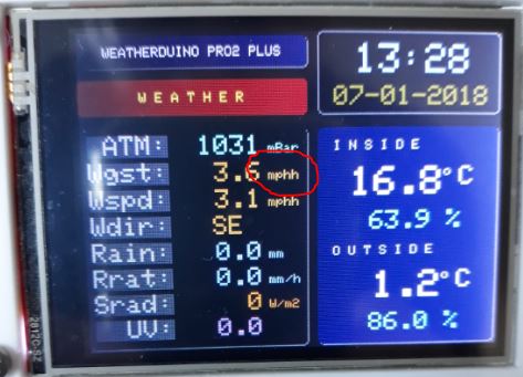

Don't know if anyone else who uses the wireless display has noticed, but if you are using mph as the wind units then after the initial startup where it displays km/h the wind units will change to mphh as below.
[attachment=1280]

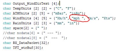

To get rid of this I have added a space in the code for the wind units, changed "mph" to "mph "
[attachment=1281]
