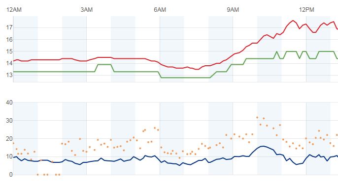

I am running the latest firmware in my Pro2Plus. I had some sensor issues which I repaired and also the Mini had a port die due to a cable had rubbed through on my mast. So when it was all fixed I upgraded the TX and RX to the latest software. Attached is a screengrab of the wind. The gusts can not be this big. The wind measurements seem to probably be ok but I dont understand why the gusts are so high. This was also a issue on the original software I had loaded before the sensor hardware failed. Here is a link to the wunderground page as well

The gust value that is reported to WU, its the value of the highest gust registered between each upload period. I agree that they seem somewhat high, however I don't have any idea why it is happening with you. The routines used to read the wind gust are in use since long time, and I don't have any other reports about this matter.
The picture below is from  WU ilustrating my readings:
It will be useful if you could take some graphics locally (with cumulus), as they will have a greater sampling rate, they could help to see it those high values are spikes.
