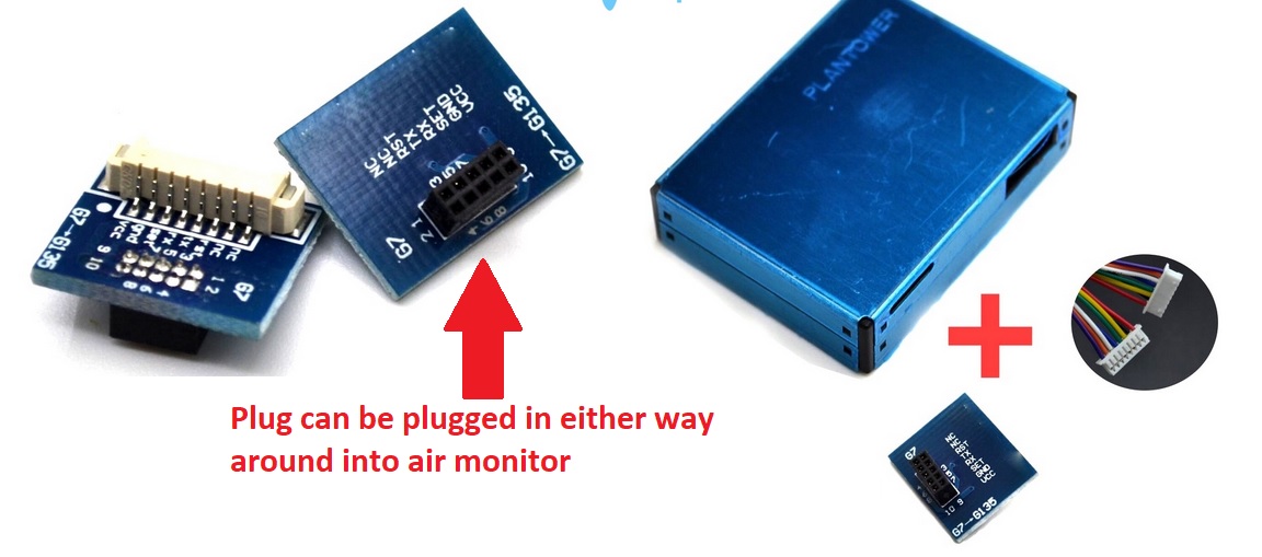

Hi Jim
On my very first day of powering up the Air Quality board, I had similar results to what you mention above: A regular red glow from the CO2 sensor, LEDs illuminated on the Nano but nothing else worked. I would not get any flashing TX light or data upload.
My solution was I found that I had connected the quick connector pins around the wrong way on the PMS7003 at the sensor itself. When I unplugged and turned it around the correct way, everything came to life.
Not sure if this is the same situation as to what you are facing however. I attach a photo of the plug I got with my PMS7003 and you can see how easy it would be to get around the wrong way.

Thanks for your input, but I realised early that the plug was reversible so I hunted the web for a data sheet to get a pinout of the sensor and the correct orientation is with the small pcb overhanging the sensor as the photo of your installation shows.
