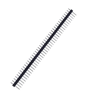

I would like to have an opinion / advice.
I plan to mount the RTC / RX-TX / Barometric / I2C T ° modules with rails (2nd photo).
I find this solution easier to organize and troubleshoot in the future.
In this picture of the assembly, they are mounted directly on the PCB.
My question: the rails will disrupt the quality of the connection?
Good or bad solution?
Thank you

If using Molex or a reputable brand of connector then they should be fine. A lot of us are already using them.
As a side note in the 2 picture we call those "male header pins" and the part that connects to them "female header plugs". That said they could even be called something else in other English speaking countries, especially America where for some unknown reason they really messed with the English language Smile

(14-09-2017, 08:52)uncle_bob Wrote: [ -> ]As a side note in the 2 picture we call those "male header pins" and the part that connects to them "female header plugs". That said they could even be called something else in other English speaking countries, especially America where for some unknown reason they really messed with the English language Smile
In America we refer to them by the same names you used.  Wink
