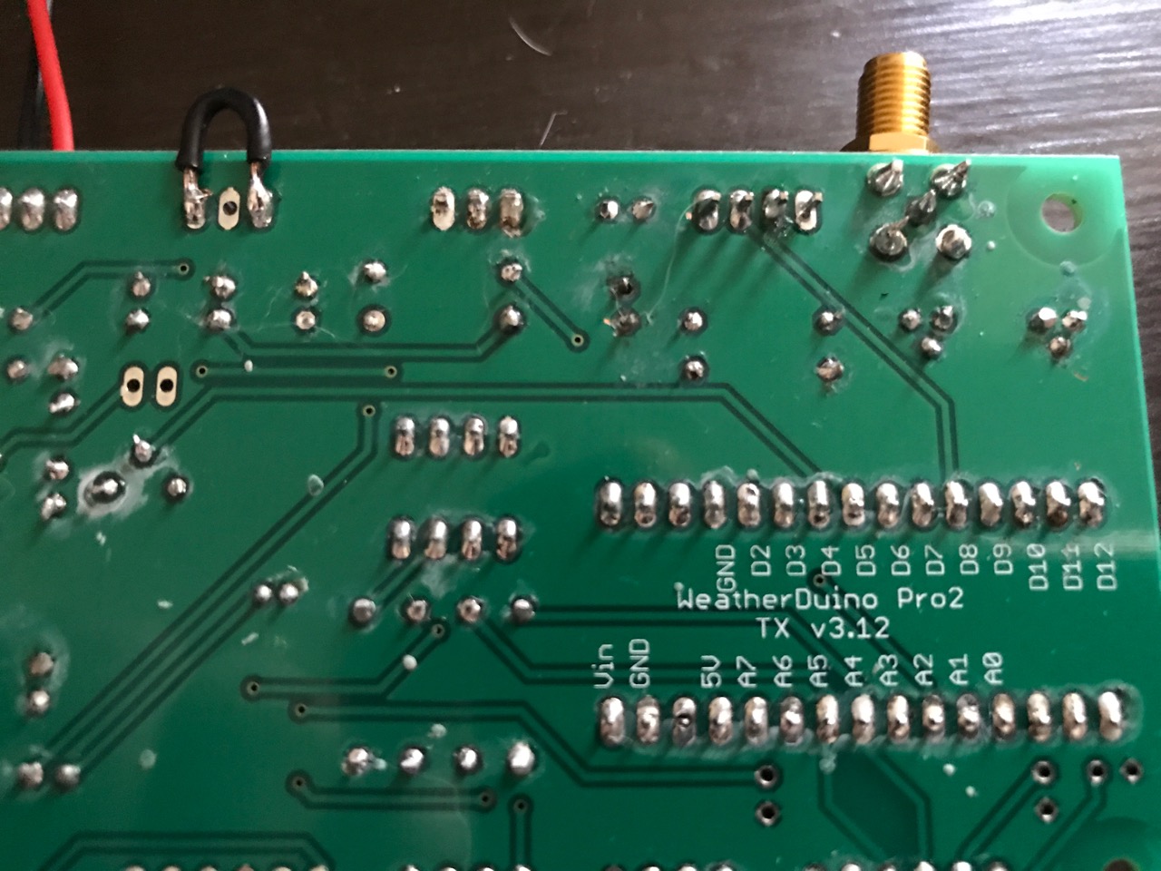

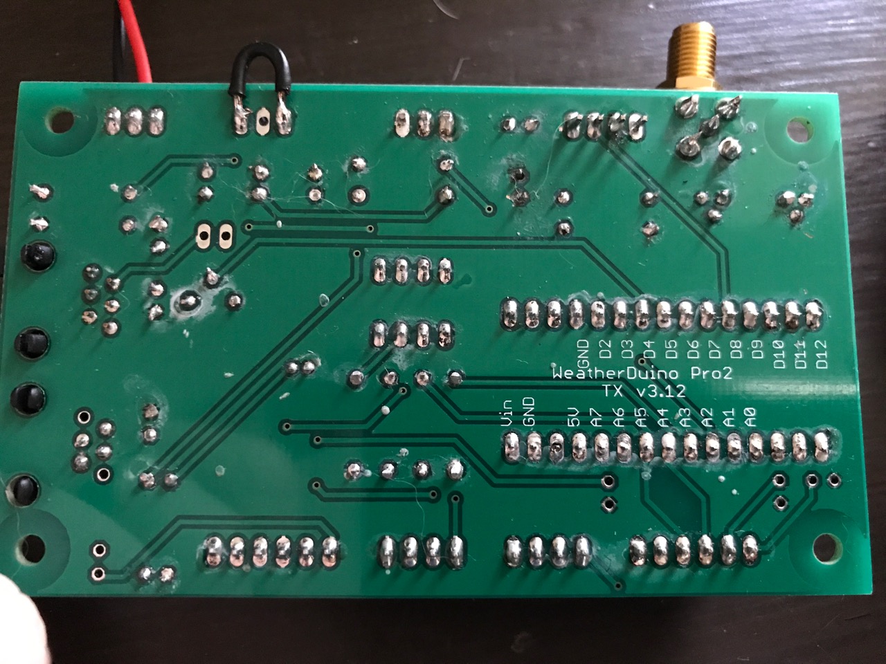

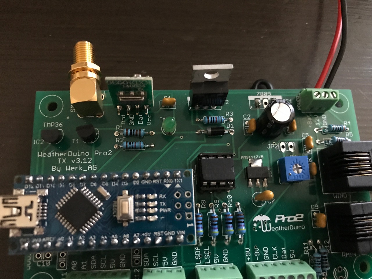

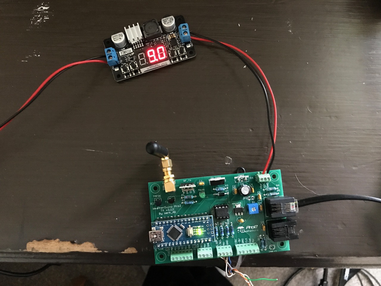

Could you send some PCB photos (in details, please) to this forum???
Hi Chris,
Pictures of the TX board will be very helpful, and please add copies of your configuration files (both, RX and TX). Don't forget to omit any personal data as passwords to wifi, etc, etc

Here are the images of my PCB -
[attachment=1035][attachment=1036][attachment=1037][attachment=1038]

I hope the photos are detailed enough.
Chris
Hi Chris,
Thanks for the pictures and config files, I don't see anything wrong on the configuration.
If the TX LED lights up every few seconds, this means the TX module is being powered correctly, however if you can't see any signal with the SDR dongle this may indicate that the TX module isn't working. Also check if the TX module is the 433Mhz model, some times sellers send 315Mhz versions.
By the pictures, it also seems that the Ant pin is not completely welded, could you check that?

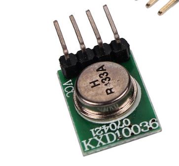

If you have a spare module try changing it, if you have to buy another TX module, try this ones:
[attachment=1039]
Your and the one above, usually have the same reference, but I suspect that those new KXD10036 doesn't work very well when powered by more than 5V, despite the sellers say they can be powered to up to 12V.
I have good news! The cause of the problem has been found and fixed and the TX unit is definitely working   Smile
I asked one of my colleagues to take a look at it for his opinion, he did a continuity test on the 9V pin on the transmitter module and found there was no power getting to it. On closer inspection it looked like the solder hadn't flowed properly so he kindly re-soldered the transmitter. If I use my SDR dongle I can see a transmission every five seconds and my RX unit is now receiving data from the TX unit.
I should have checked that first before coming on here for help but thank you for your time anyway.

Thanks to you, now we all know that those new KXD10036 modules work.
