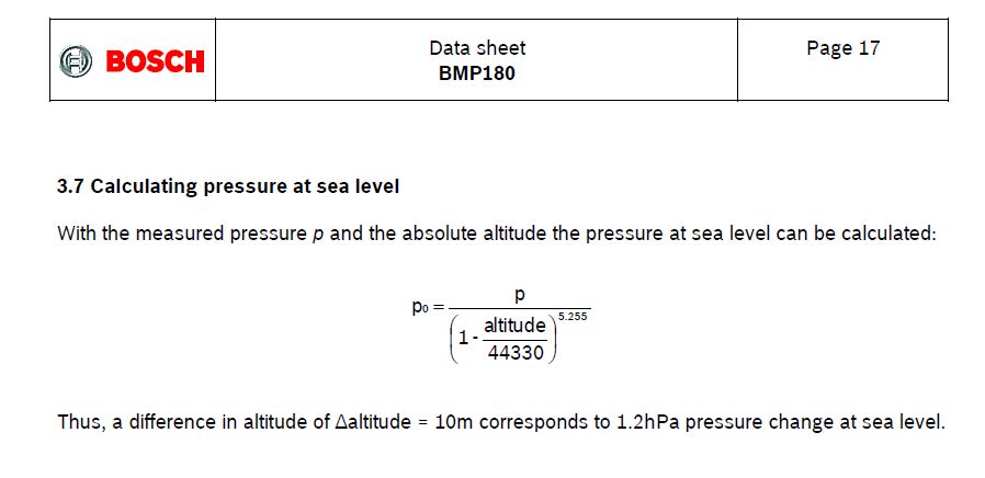

Hi, can you please write this formula in plain mathematical form? I do not understand the C version. Thank you!
Welcome to the forum. The formula is on page 17 of the BMP 180 data sheet.
It needs a power of 5.255 so you need a reasonable maths package, or a lookup table method if only a basic software language is available.
[attachment=1262]
