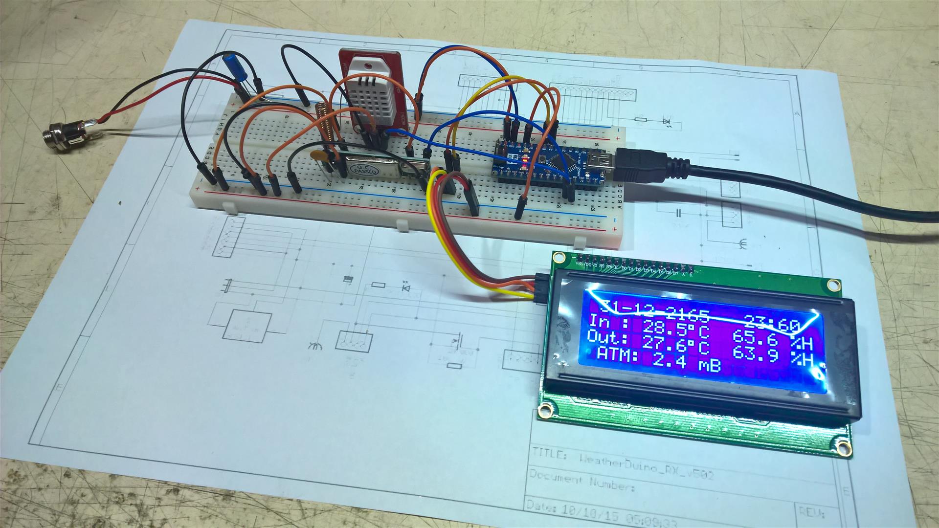

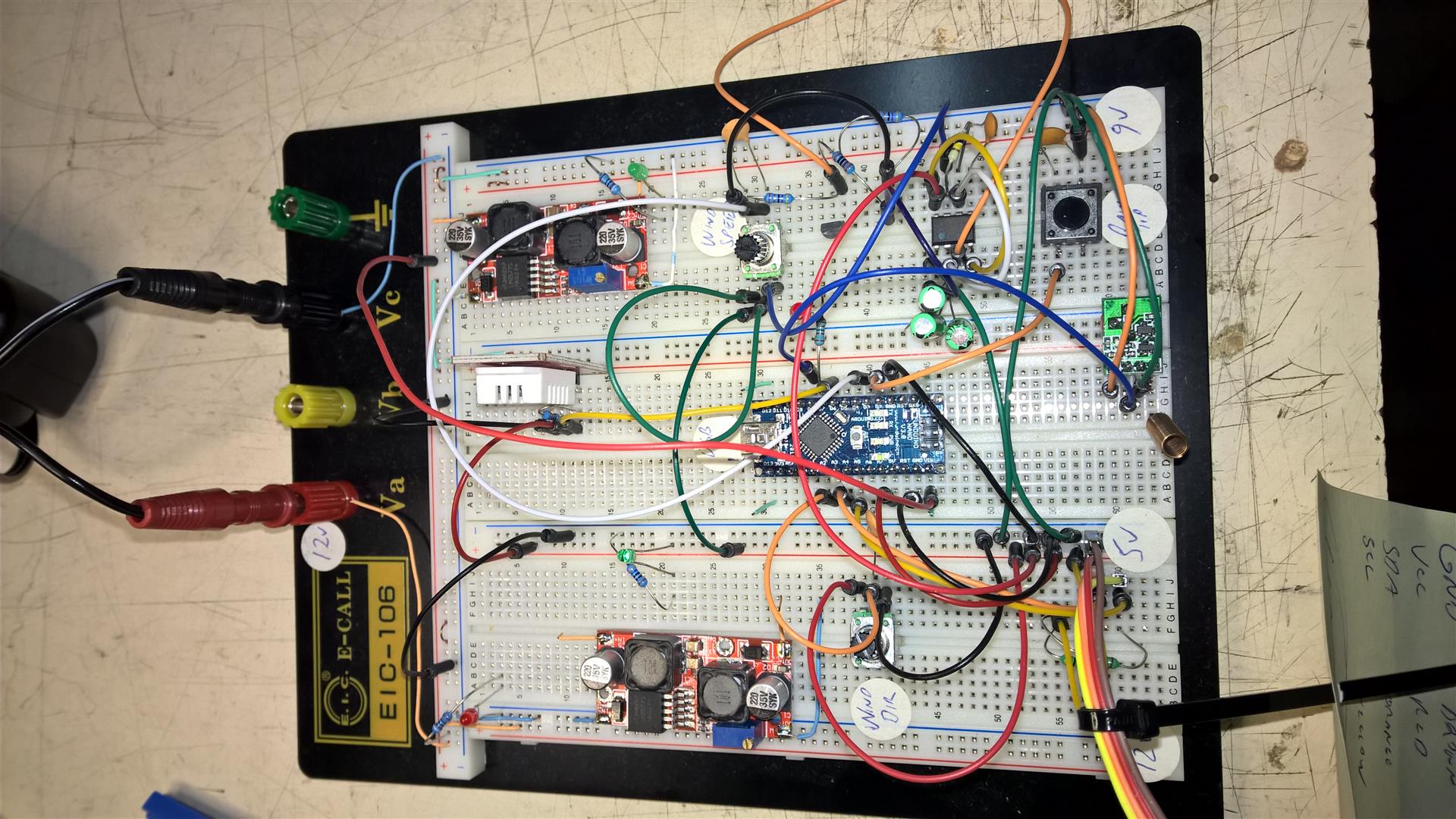

I had a test Pro2 transmitter station on bread board, and it didn't take long to create a test Pro2 receiver station on breadboard as well.  Using these test stations as a set, I was able to test these new 433Mhz modules, and they were totally solid and no corrupt packets when used as a new pair / set.  I was even able to take the test TX station outside and get solid link back into my workshop where the test RX station was located.  All good when used as a new set (ie. a set of TX and RX modules purchases as a pair from the same seller / manufacturer).  But as soon as I mixed my old Pro2 TX station with the new 433Mhz RX modules, I experienced issues again even over short distances of a few meters.
[attachment=920]
[attachment=921]

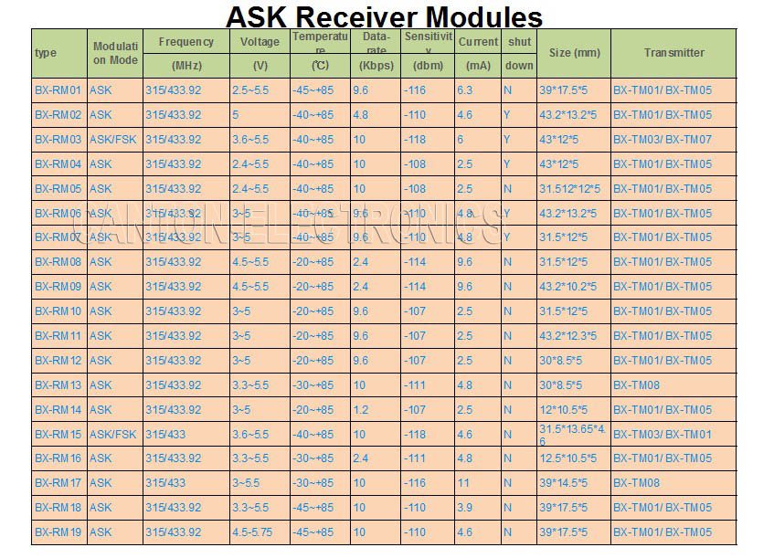

As a reference guide, I found this TX / RX compatibility chart online.  As we are using the RM06 433MHz ASK RX modules it confirms that we need the BX-TM01 / BX-TM05 TX modules.  This chart may help someone identify if they are about to buy a correct (or incorrect) matching module, as there are "many" out there on eBay...
[attachment=922]
Regards, Mark R
Mark,
Since the frequency and modulation used are the same, all modules work with each other.
There are lots of people including me, that are using the old TX boards equipped with an FS1000A transmitter, and it works perfectly with the RXB6 receivers.
The table, above also confirms that, as you can see BX-TM01 / BX-TM05 transmitters will work with all receivers on the list, except the ones that are FSK, of course.
There isn't that thing of a paired RX and TX module, only some are of better quality than others.
I also know of some RX modules, very similar to the RXB6 (even the PCB is the same) what doesn't work so well, and is because of that that I always recommend the ones that have RXB6 market on the back of the PCB.
Canton-electronics is a reliable supplier, but don't thrust in everything you read on their eBay website.
